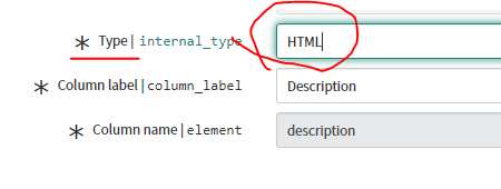

Do you perhaps mean like having an "HTML" type field? Have you considered changing the Description field to this type?
Be aware this has larger impact, since this probably is a field on the task table.
So on the Dictionary Entry of Description field, update this field from String into HTML:

It is better to create a new Field instead of changing the field type of the existing Description field. Because in all the task-based tables the change will be reflected.
You can create a new field with field type as HTML and change the label of that field to "Description" and remove the existing Description field from the form using the list layout.
