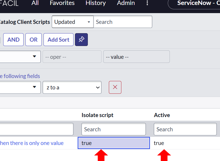

Sharad
Hi @maroon_byte, how are you?!
I accessed the "catalog_script_client" table and checked "true" (isolate script and Active - img), but that didn't work. ;(
Do you have another suggestion?!
