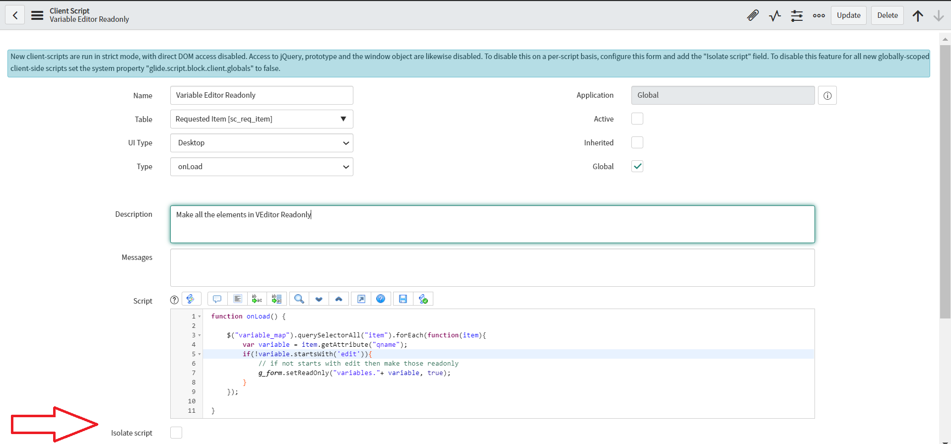

then you need to do this
1) normal client script on sc_req_item table
Ensure this
1) Isolate Script field is set to false on this client script
2) if this field is not on form then from list you can make it false
This will make all variables readonly except those whose name starts with edit
example: edit_user, edit_group etc
function onLoad() {
$("variable_map").querySelectorAll("item").forEach(function(item){
var variable = item.getAttribute("qname");
if(!variable.startsWith('edit')){
// if not starts with edit then make those readonly
g_form.setReadOnly("variables."+ variable, true);

‎07-01-2021 10:21 PM
this script should work fine in normal client script on sc_req_item table
g_form.setVariablesReadOnly(true);
