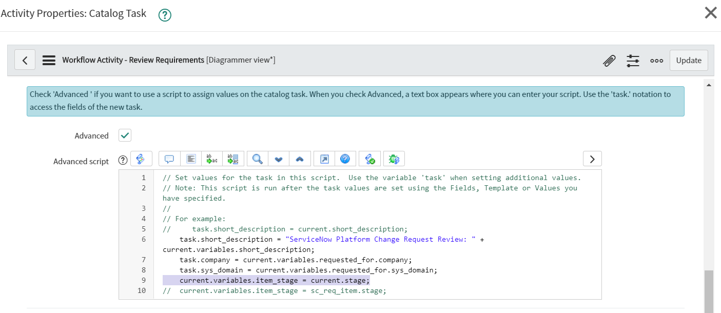

I'd like to show the stages of a requested item on the RITM. Since I only want this to only show for this particular catalog item, I created a variable "item_stage". Whenever the stage changes, I want the RITM variable to be updated. What I tried to do is that every time the SCTASK is created, I run this script:
current.variables.item_stage = current.stage;
I'm not sure if this is the best approach or the right syntax. I can't get this to work because the field is just blank:

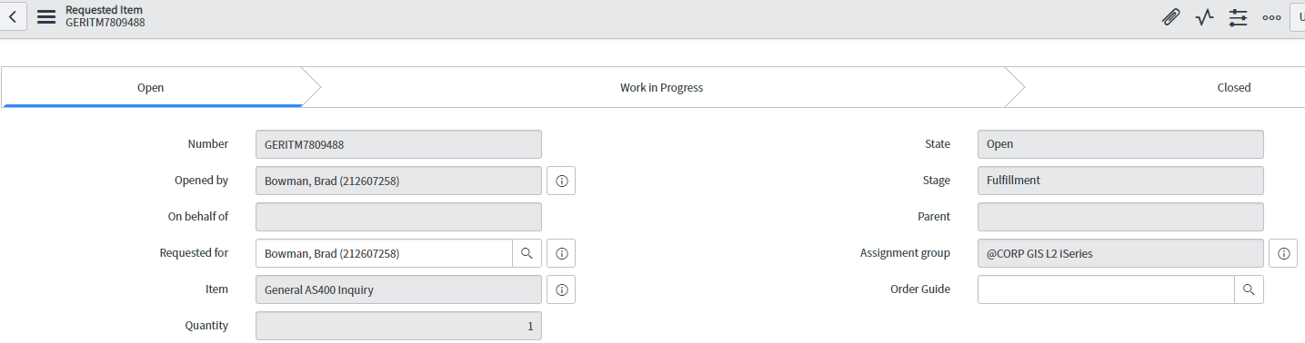

I like this idea, Brad.  How did you get the workflow chevrons to appear at the top of the RITM?  I'm not actually sure what they are called.  Are they an option when selecting a variable type?
Thank you!
You can find that in Process Flow in the left nav.  On the sc_req_item table you would create a record for each chevron that you want to appear, giving it conditions for when that one will be active, then if it's not already there, add Process Flow to the form via Form Layout / Designer...
