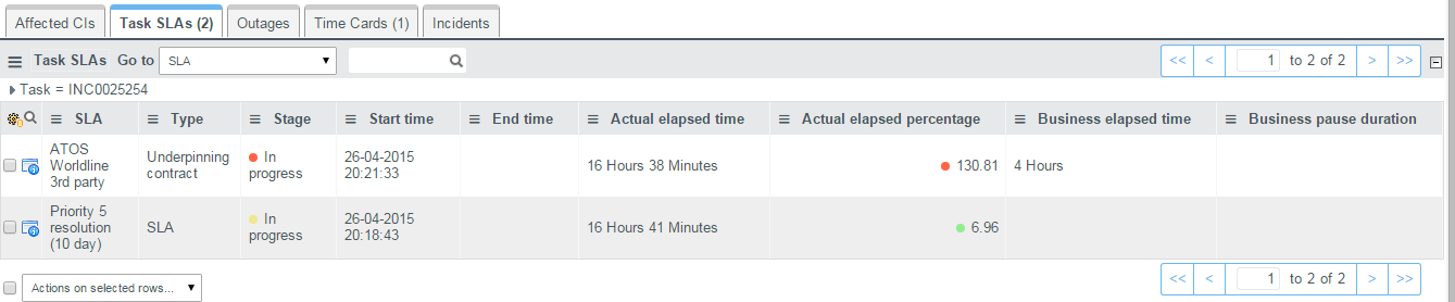

Lastly here is the incident with the SLA on it:

Hi Ryan - The rule seems to be working as designed - here is what I see:
  • Started at 20:21 (8:21 PM)
  • Has run for 16 hours : 38 Minutes (makes the time 12:59 PM)
  • Your SLA is set for 9-5 so the elapsed Business time of 4 hours appears correct (started at 9 AM)
Am I misinterpreting something?
Cheers
Hi Andrew,
Should the elapsed business time not be 8 hours? as it should of run between 9am and 5pm?
The incident has never left the start condition of the SLA and is still in Awaiting Third Party so the SLA time should still go up, as you said it seems that the SLA must of stopped running at midday.
