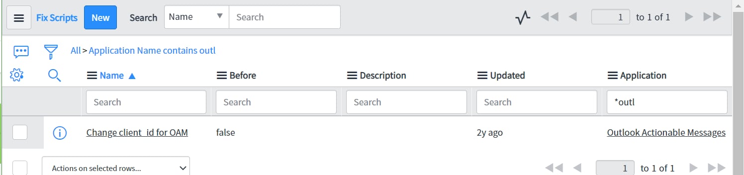

There is a possibility that the credentials have been overwritten.
To populate it correctly there is an OOB fix script. You can remove the client secret from the application registry and run the fix script to check if it is working.
I am pasting the screenshot of the script below:
Before executing this script, check that the sys_id is same as the record in application registry and also remove the "client secret" from the already existing record.
