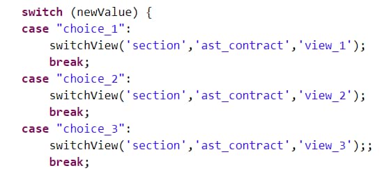

I tried to do the same logic in onChange client script but I need to save the record in order to display a view.

you can use onLoad client script to check the field value ans use switchView()
OR
you can use onChange client script and switch the view but remember it would save the form before switching
