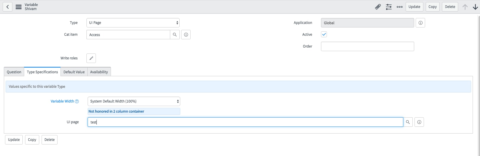

Try to create an exclusive variable as mentioned in the below KB article, it will come in ESS portal of the catalog item as it will be variable on the catalog item -
ServiceNow KB: How to add a custom 'Add Attachment' button to a Service Catalog Item (KB0529497)
Shivam
1. Create a UI Page :
2. Add UI page variable in your catalog Item :
3. Add Attachment from the ESS portal page :
