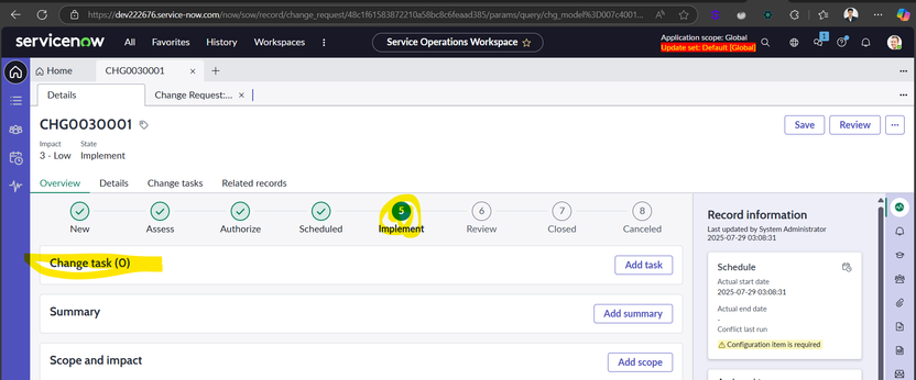

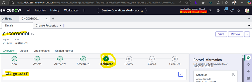

When I update the state of a Change Record from the SOW( from Scheduled to Implemented), the Change Task section on the Overview page does not automatically refresh to show the correct task count. I have to manually refresh the page to see the updated information.
I’ve attached screenshots showing the view before and after a manual refresh for your reference.
Before Refresh
After manual refresh
Thank you!!

Thanks again for your responses and support. I did some more digging and noticed something interesting—while the Change Task section in SOW doesn’t auto-refresh, the record does get updated in the database. I confirmed this by checking from other views, where the task count reflects the correct value immediately after the state change. So it seems the backend update is happening as expected, but the UI in SOW isn't picking it up in real time.
Based on your suggestions, I'll explore adding a client script to trigger a refresh when the state is changed client-side. Appreciate your insights, and I’ll mark your replies as helpful to benefit others in the community as well. Thanks again for your continued guidance 🙏
