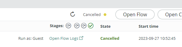

We created a button (UI Action) on the RITM form to quickly convert a request to an INC
When we click the button, the stage is set to "Request Cancelled", the State is set to "Closed Incomplete" and the flow is cancelled.
This example closed/cancelled successfully.
The issue that we run into is when the flow doesn't stop right away and generates a bunch of open tasks before cancelling the flow. I've had this happen to the same person on the same ticket type where the button it works one time but not the other.
The only thing I can see that is consistent on tickets that generate tasks by mistake is the cancellation of the flow is run as Guest but I can't figure out why.
