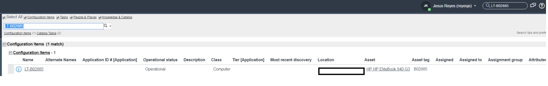

For some reason I'm not able to find (some) assets in the Asset Table. I see them when I search for them (using the Search field), please see screenshots below.
Example: Configuration Item LT-B02885
Using the seach field I find the following:

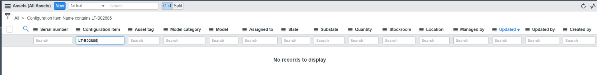

I'm able to find the record only by entering the serial number, see below. However, the CI name does not match. Is it because it was recently deployed?
Please advise!
Thanks!
