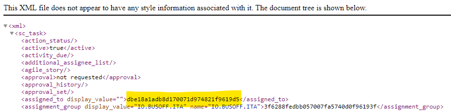

the Name variable is reference to group members table while it should be to sys_user table with reference qualifier the group name they are member of
the problem with your setup is that you are filling in data from a table and populate it to a field that reference another table and then when you select the members from the new table you are not getting the expected output (Sys_ID) of the user but you are getting the Sys_ID from his membership of a group
to fix this issue, change the name to be reference to active users in the Sys_user table

Please open the Task and see record xml using show XML option. See if there is any sys_id in assigned_to field.
As assigned to field is dependent on Assignment group, so it will ignore the value set in assigned to field if user is not member of assignment gorup.
