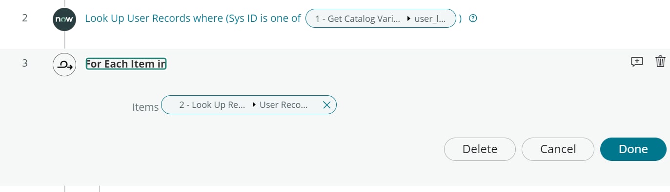

Hi Mahendra,
Thanks I know that solution will work but role will not be possible to provide to normal account.
I have another option to make it on flow designer.
I use look up record but how can i get all the record using look up is there something that can we do ?
Hello Jeckson,
There will be an action Look up Records and using that you can get all the records matching your condition. Also you have to make flow to run as System user otherwise I think the ACL will not allow to update the active field on sys_user table.
Please mark my respsone as helpful/correct, if it answer your question.
