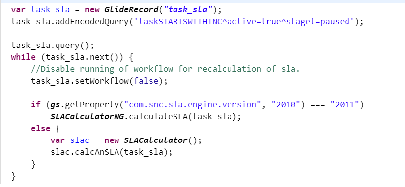

thanks for your reply. What I am trying to do is have it update automatically, so I am also trying to create a fix script and then create a scheduled job that would call that fix script. I am able to call the fix script from the scheduled job, but having trouble getting the fix script to run. Below is the code for the fix script. The code next to the blue line is the exact code from the "calc SLA's on display' business rule. I am not getting an error when I run it, however, none of the current task sla's for incidents are updating. Anything I am missing here?:
Yes, in the 1st wile, it should be gr.sys_id, not current.sys_id. Also the filter for number is wrong: the 1st parameter should be 'task.number', not 'task' and the 2nd parameter should be (a string) 'STARTSWITH' and the 3rd parameter should be (also a string) 'INC'. But the script is not what I would do. It needs to be rewritten from scratch. Right now it starts by loading ALL records in table Task. That means also changes, problems, projects, etc. And then it tries to only handle incidents. That can mean loading millions of records just to handle hundreds or thousands of records. You should start by loading just incidents by writing GlideRecord('incident'), not GlideRecord('task'). Because table incident extends table task, any incident can behave as a task (but not the other way around). Identifying incidents by number is not a good practice anyway. A task's number can deviate from the regular number format in a variety of circumstances and can thus start with something else than INC. Incidents should be identified by Task type - a field all tasks have (so incidents, problems, stories, projects, etc. too). Or by selecting from table incident. I hope it is clear that selecting incidents should be done by specifying incident as table and that the extra query for incident no. is both wrong and not necessary. Lastly, code that is to be reused must go into Script Includes. Fix scripts cannot be called from Scheduled scripts - I don't know how you think you did it. If you need to call some code both from a fix script and a scheduled script, the code should be defined in a Script Include.
