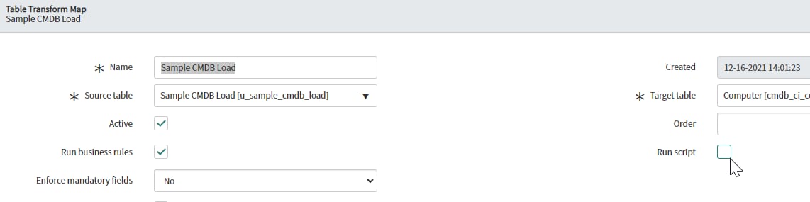

‎02-16-2022 01:41 PM
I'd recommend placing this within the script for the transform map itself (so not a field map script or an onBefore/onAfter script etc).
Then use the script as we've previously discussed where
if (action == 'insert') {
target.field_name = "External"; //or target.field_name = source.field_name
if on action == insert, it does 'x' then use target.field_name = "External";
Otherwise, it won't do anything else and won't mess with the field, etc.
