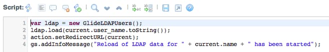

I have noticed sometimes it takes a while for the Active Directory user changes to replicate to the Domain Controller that ServiceNow is binding too. You may be able to leverage the code from the UI Action and schedule it to run a few times.
Normally, the out of box, LDAP Listener detects the changes fairly readily if configured properly.
