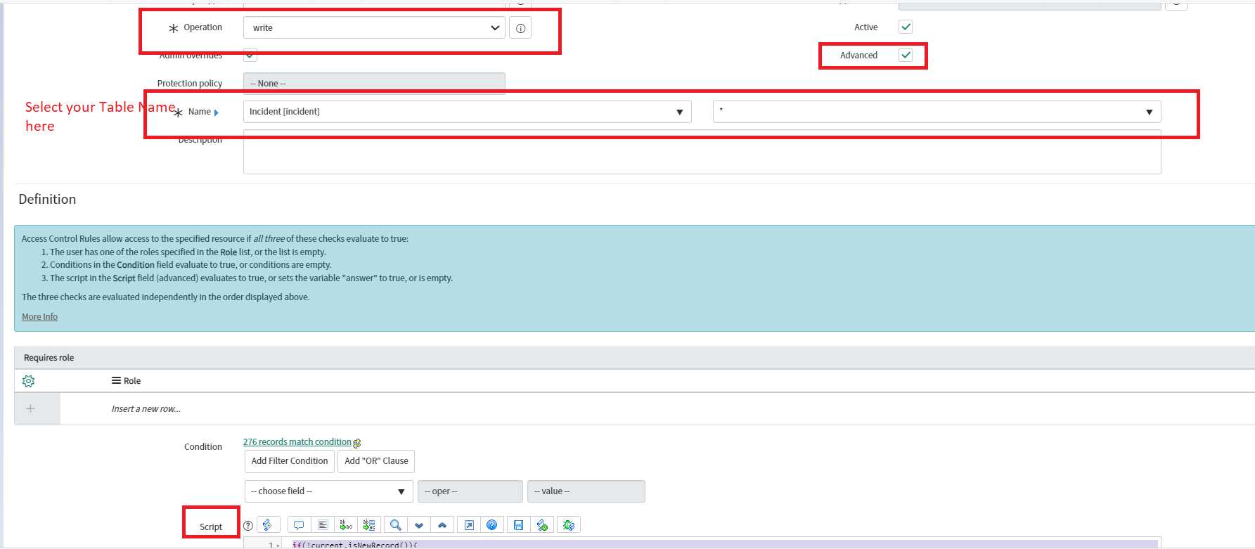

1) First option: You can make the Fields Read Only after the record is inserted so that no one can update the field values.
So for that Create a Field Level ACL on the Table "User Restrictions" and use the script as below:
if(!current.isNewRecord()){
	answer = false;
}else{
	answer =true;
This will make all fields as Read only for existing records. You also need to check if there are any other ACL present on the User restriction table or not which is existing and giving access then you need to update those as well to restrict it.

ACL should be the preferred method, have shown you both approaches which ever you think is appropriate based on your customer scenario you can follow that.
