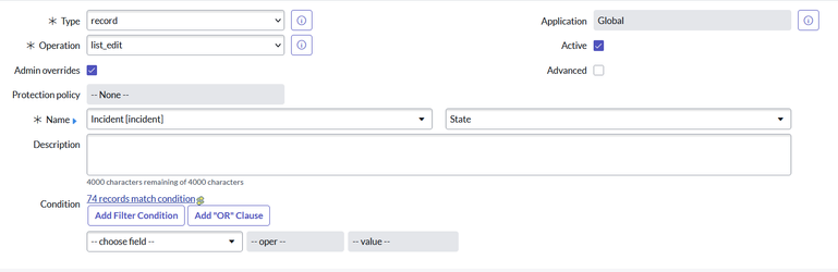

Hi @Bcrant ,
You can create an ACL on incident table for the operation 'list_edit'

Hi @Bcrant ,
As @Karan Chhabra6 have suggested, you can create an ACL for that purpose. Though, I would recommend you to instead look at why they need to change state from a list view. I would go the other way, and limit the possibility to change state from listview.

Bcrant
Thank you both for the feedback. Since we do not want to restrict the ability to edit state from lists, I've decided to create a data policy which works both on form view and list view. I still have my UI Policy to hide the On Hold Reason field if state is anything other than On Hold.
