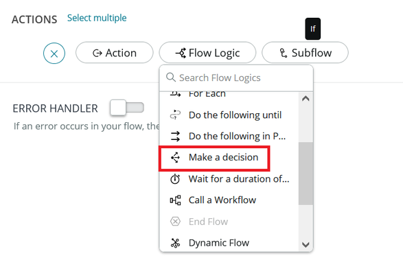

What are different ways to trigger a decision table inside a catalog item flow?
felix shraga
How do I call a decision table inside the flow? How do I trigger it? I know how to call a flow inside a decision table but not vice versa
Karan Chhabra6
Hi @felix shraga ,

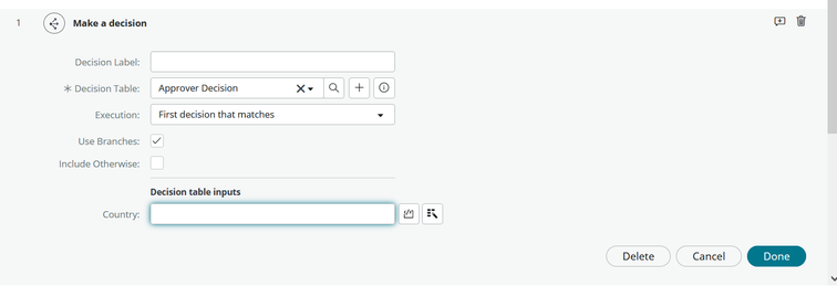

There's a flow logic named "Make a decision", you can leverage this to call decision tables from flow.
Once you select this, select the decision table,execution type and provide the inputs
