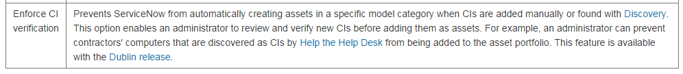

Robert,
This allows you to create a CI (manually or via some discovery source) and it will not automatically create an asset. With it turned on, when new CIs are created, they are automatically flagged with the Requires verification field as true, and those CIs present two options when you view the CI record: Create Asset and Merge CI.
As you might expect, Create Asset creates an asset and turns off the Requires verification flag.
Merge CI is useful for a situation where an asset for that particular CI was created via a separate process (which would create an associated CI) and another CI was created either manually or via the discovery source and did not properly coalesce on the CI created by the asset. This allows you to merge these items.
Typically you would end up with an "Unknown" asset if you did not define a Model ID on the CI, but with Enforce CI verification on, that should not happen until you tell it to create the asset. If you are seeing otherwise, I would be curious to take a look to see what might be happening.
