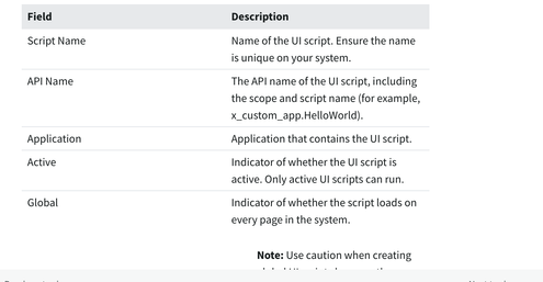

Product doc for UI script- (check the demonstration of each file of UI-script form)
https://docs.servicenow.com/en-US/bundle/tokyo-application-development/page/script/client-scripts/co...
Note:
-Use caution when creating global UI scripts because they can impact performance. You cannot create a global UI script in a scoped application.
-UI type - if we want to call the UI script from ClienScript, then we need ‘Global’ field checked, for that UI type should be ‘Desktop’.

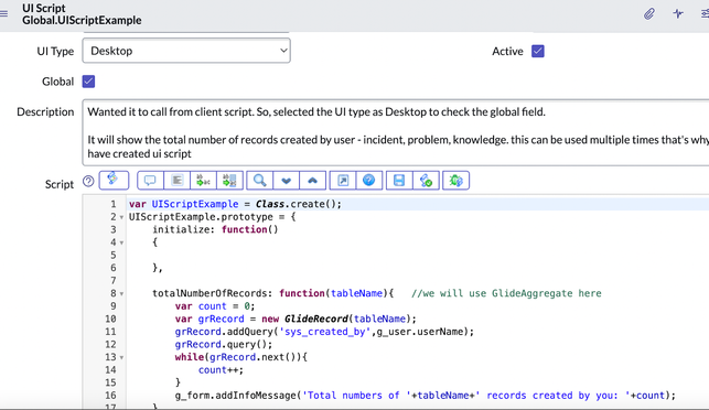

Let's work on very simple example- The key here is to understand the importance of UI script, not to achieve the task.

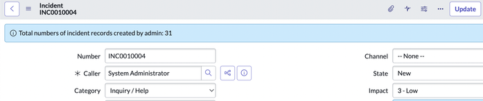

Use case - when a user creates any record such as incident, knowledge, problem, change etc. He should get the message on the form that how many records are created by him. e.g. if user has opened the incident form, user should get the message something like 'Total number of incident created by 'username' - 40'.
Solution - The logic is going to be the same, no matter which form or table he is working on, we just need a table name and based on 'table name' we can get the total number of records created by a user.
'Reason to use UI script' - we want this message on the form and when the user loads the form. So, we will be working at client-side and we know our logic is reusable for multiple tables.

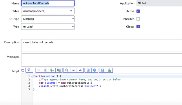

Hence, we'll write a function into UI-script and then will call from client scripts.
Below client script, we have written for 'incident' table. For knowledge, problem records you can write it the similar code.
