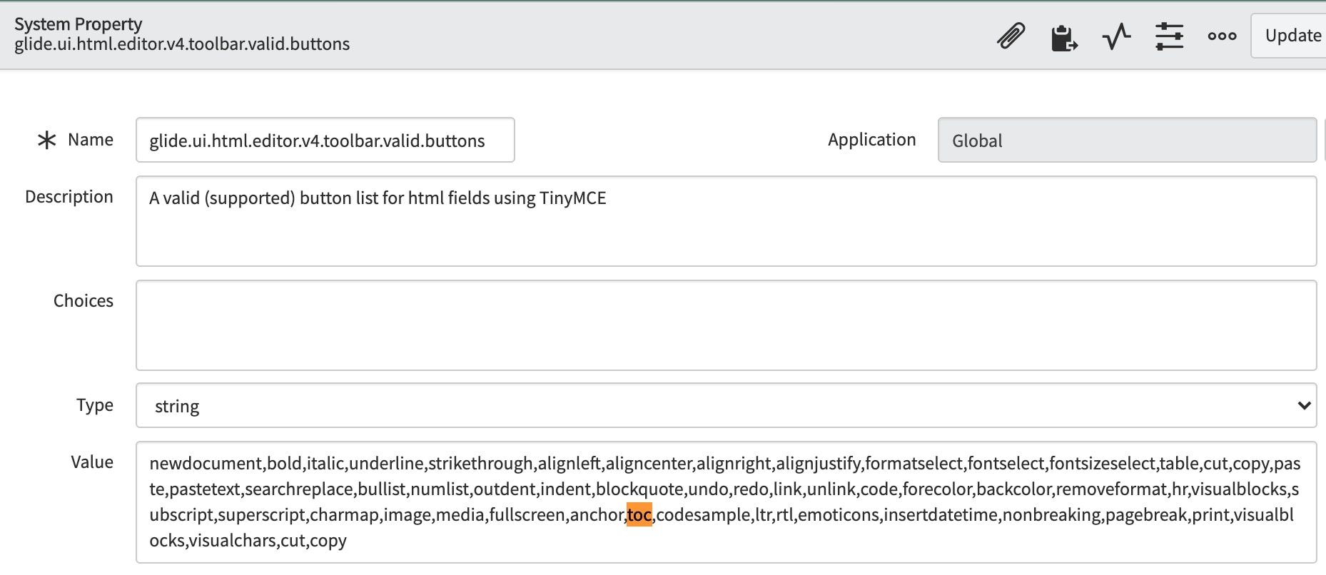

I am trying to enable the table of content in the html editor, but it looks like the option does not exist.
I have tried the following so far:
1. Inset table of content:
https://docs.servicenow.com/bundle/quebec-servicenow-platform/page/product/knowledge-management/task/insert-toc-html-editor.html
that did not work as the button was not available.
2. then I went to
https://docs.servicenow.com/bundle/quebec-platform-administration/page/administer/form-administration/task/t_ConfigureTheTinyMCEHTMLToolbar.html
that did not help
3. then I went to this
https://docs.servicenow.com/bundle/paris-platform-administration/page/administer/workspace/concept/tinymce.html
4. after that I started experimenting  and  modified that value field for glide.ui.html.editor.v4.toolbar.valid.buttons to include buttons that I could not see (anchor and toc), that did work for the anchor but not for the toc.
so right now I do not know what else to do to get the toc and the toc update available in my HTML editor

Today, I tested this feature in more detail in three of our demo instances: Quebec, Paris, and Orlando. Here are my findings:
  1. In Orlando: "toc" is not by default included in properties glide.ui.html.editor.v4.toolbar.valid.buttons and glide.ui.html.editor.v4.toolbar.line1. And even after I added it manually to both properties, the "toc" icon didn't appear in the toolbar.
  2. In both Paris and Quebec, "toc" is by default included in property glide.ui.html.editor.v4.toolbar.valid.buttons, and the "toc" icon appears in the toolbar even it is not in the value field in glide.ui.html.editor.v4.toolbar.line1. See the screenshots from the Paris instance:
My personal conclusion: "toc" is a feature that was added in Paris, and your instance was upgraded from Orlando or an earlier version, but something went wrong during the upgrade, and this is the reason why this feature is not available there. I think you have two options: either instance z-boot or to report an issue on HI.

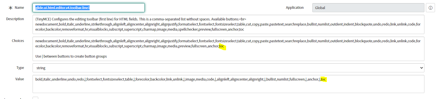

That's strange, indeed. I have just tried it on my PDI (Quebec), and it works as described in the documentation.
1. I have updated property glide.ui.html.editor.v4.toolbar.line1 by adding the element toc.
2. The icon appeared in the editor, and it worked; see the screenshot:
3. Maybe you can try to use it in another instance?

This is how my toolbar looks like after all the changes:
Available buttons:
glide.ui.html.editor.v4.toolbar.line2
To be honest I am not sure where else to look to get this fixed...
@Jiri Skala yes I have tried that on other instances available to me (they are all clones of one) but still the same result. Would you be able to share screen grabs of your settings for: glide.ui.html.editor.v4.toolbar.line1, glide.ui.html.editor.v4.toolbar.line2 and glide.ui.html.editor.v4.toolbar.valid.buttons?
