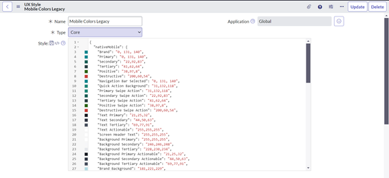

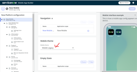

I would like to be able to make the background being white. So I looked for the theme of my mobile application and found this :
So I looked on my Mobile UX Themes and tried to tweak some rgb values but without success :

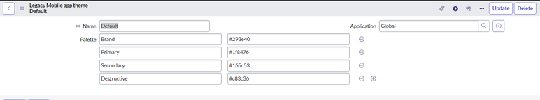

Hello @Damien1 ,
You can go to this table 'sys_sg_client_theme' or search on navigation 'Mobile app theme' and open the theme that you want to change the color and change it.

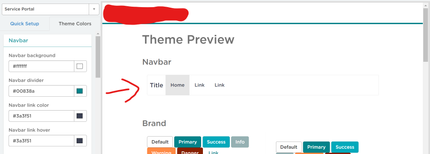

However when I go to my Branding Editor on my portal, I can clearly see that my navigation bar is white :

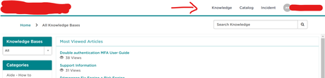

Even when I go to the Service Portal on my computer, I can see that the Nav Bar is well customized :
So I don't understand why it wouldn't be the same on my now mobile application.
