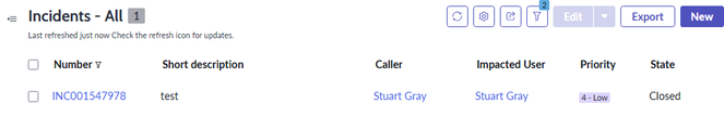

I am using SOW for ITSM Apps V6.1.5.
In our client instance, VIP caller is not getting highlighted on the SOW list view as shown below,

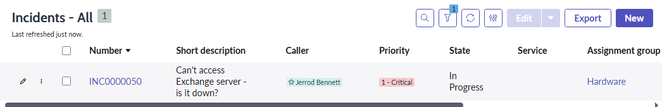

But on the OOB PDI instance it is working as expected as shown below,

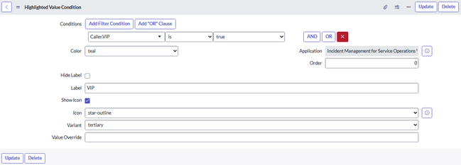

Below is the configuration present in both Client & PDI instance,

You are correct it should work. In fact it is working in my PDI as shown in my original post. Only issue here is it is not working on the actual client instances.
To give you additional information, both instances are on same SOW version but if you will look closely to both the SS of the list view, the icons are different. So what I am anticipating is it might be some issue with UX Screen which is rendering the LIST view.
