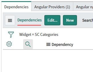

I think you can try hookjs into the widget SC Categories of page sw_sc_category
Then, in the hookjs, you can do everything that you want to: redirect to another portal, modify URL
Note,
To hook, you just add dependency into this widget
Hope this help!
