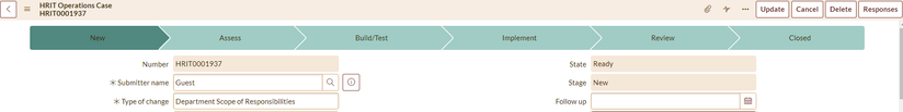

Hello, for the next experience Polaris UI, we created some custom theme variants. When we apply those themes and open records in classic view that have a process flow formatter, I noticed that the formatter does not adapt to the theme colors. Anyone have any suggestions on what am I missing?

I just ran into this exact question and found a solution. The Flow Formatter color is based on the "Grouped Teal" colors that you set in your theme.
If you go over to the Color Generator that the Next UI Center of Excellence provided:
  1. Click on the "Grouped" tab
  2. Input a hex value into the "Grouped Teal"
  3. Then click "Copy JSON" at the top
It should output some JSON with the different Teal colors for you. Put those into your theme and the Flow formatter should follow suit. As a note - I placed them in both my UX Style that's related to my UX Theme and also into the "Legacy: Experience Theme" tab of the UX Theme.
FYI - I don't know what else the "Grouped Teal" colors are used for, so you may see other changes that I haven't yet!

That did the trick! Thanks a lot!

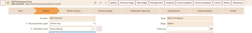

xiyan_li
 How did you change the color of this Process flow formatter
