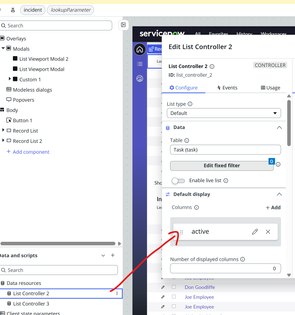

When I add a Record List to my page, I can define the columns like so:

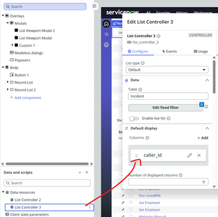

But if I add a second record list to the page, I get this:
So my first list is fine, but on the second list I have no idea what to do. Why is the presentation different, and how do I figure out what goes in this property?

Hello, I tried this on a new page, and I don't get the issue :
Do you have UI builder application updated to latest version ? Could you try to do this on a new blank page to see if you get the issue, maybe you have other problem on your current variant.
Hope it helps.
Hi, the difference was that in one case I had populated a certain property of the list control, but in the other I had left it alone. With that property populated, the column selector went away. I'm sorry, I do not remember what property it was. I wound up creating a view to define the columns and filling in the view name under View (see my snapshot).
That was a good workaround, if you ever come to the same issue, share which property caused it so we could look into it.
