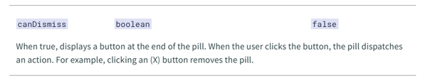

According to the Pill API documentation, I believe I am using the correct attribute and value:

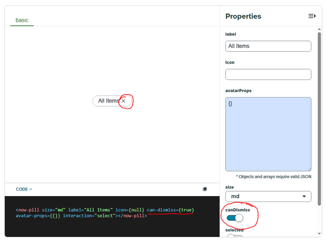

I also went to the SN Horizons page for the component and configured it their sandbox, similar to what I have, and it works there:
