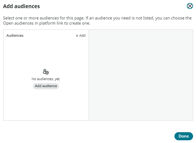

Assuming it wasn't built in global, you can use App engine studio to open the app and give you the details.
Or open UI Builder, find the variant and click on Audience to see what roles are needed to view this variant/page.

As you say, the application is not Global.
I checked Audience and nothing was specified, is it correct that the role is not restricted?

Access to workspaces is controlled by ACLs. You'll need a ux_route ACL for the workspace (You can use service operations workspace as a reference). For individual pages you can use audiences, which primarily use roles, but can also use user criteria if that plugin is enabled.
