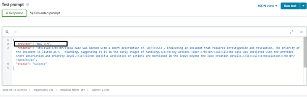

Hello @JaeggerLegane ,
1) Open your prompt in the Now Assist Skill Kit.
2) Click Test a prompt.
3) Once the test completes, click the Run test history :
Also refer this :

05-19-2026 09:02 AM
the above check I have done on the ootb incident summarization only!
