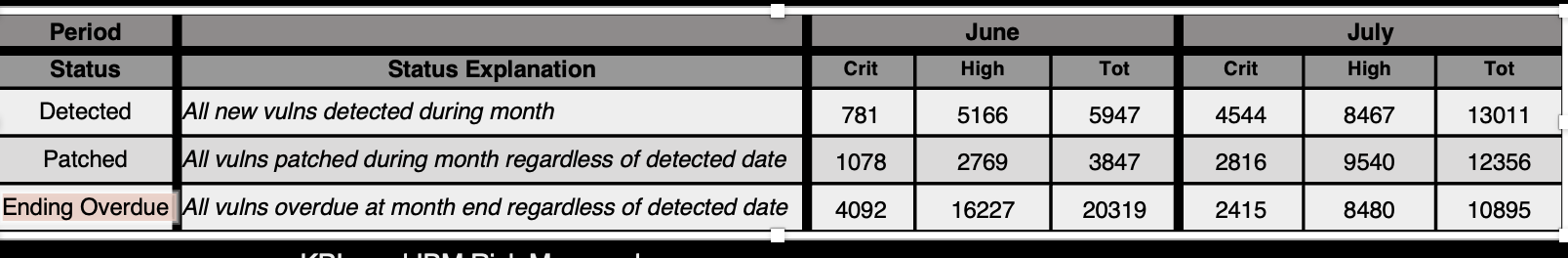

hello Hasan..I have something similar requirement. Attaching a screenshot.
As you see, in the rows we have detected,patched and Ending overdue. and columns as vulnerability count broken down by critical and high priority. let me keep the priority aside for now..
detected condition is created = this month or created - last month; patched condition is resolution date this month or last month..
now the conditions on each date field should be mutually exclusive, means condition on one date field should not have affect on other.
How do I accomplish this task? i am able to get the design for one month but unable to get the same view for 2-3 months..
My approach: created two breakdowns, one for detected ( when created date falls between firstday of lastmonth to firstday of next month then group under 'detected') similarly for patched..for me to get counts for latest two months on columns, I tried creating two indicators, one for current month and one for prior month and applying filters on dates (eg: created on this month, created on last month)..but created date filter condition is clashing with resolution date filter and giving wrong counts..
may i know how to group indicator scores based on breakdown element..if my condition in indicator is on created date, the score should fall in the intersection of detected row, if the indicator condition is on resolution date, then it should fall under the intersection with patched..
