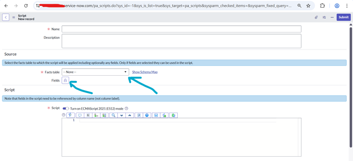

We have a Catalog Item with 2 variables (date type) and we need to show the average time between them in a Report. How can we achieve this. Please help. These variables are present on the RITM.
Should we use PA scripts and then call it in an Indicator? If so, how to achieve and what are the other approaches? I tried PA scripts, but I don't know what should the "Facts table" be and how to select the 2 variables in the "Fields" field, as I cannot directly dot-walk.

Hi @Ankur Bawiskar
Thank you so much for your valuable reply. PA scripts did not work since, those should be callable fields... Tried everything with different tables, but nothing worked.
That's why, I went with your 2nd approach to create a hidden variable on the Form and call it on the report. I took the average using Business rule for calculating average, since client scripts did not work.
Thanks a lot.
