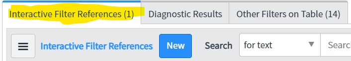

I would like some help on interactive filters. Specifically, I'm trying to get a true/ false filter relating to a referenced field:
I have a report showing Vulnerable Items, I want to be able to filter these Items based on whether the CI is 'internet facing'. This is a checkbox filed in the cmdb_ci which is referenced on the sn_vul_vulnerable_item table.
I find it strange that for interactive filters based on 'boolean', I'm not able to create the 'Interactive Filter References' like with the other types of filters

The solution I found was to code the boolean field value, using sn utils.
By double clicking on the 'field' field I was able to insert the query manually, rather than having to select from the list:
