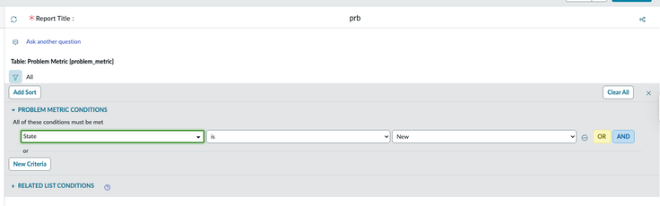

I need to create a report for problem metric to find the actual average of each state moving from one state to another and need the current state as well.
12-01-2025 03:28 AM
Add here
12-01-2025 02:05 AM
you can create metric definition similar to Incident State and do this for Problem State field
also check this link
12-01-2025 02:26 AM
Yes, i follow! But can you please tell me what filter needs to be applied. Table that i uses is - problem_metric.
12-01-2025 03:21 AM
yes that's correct
To show current problem state -> add the "State" field from the Problem table to your report so you can see the current state alongside the historical transition averages
