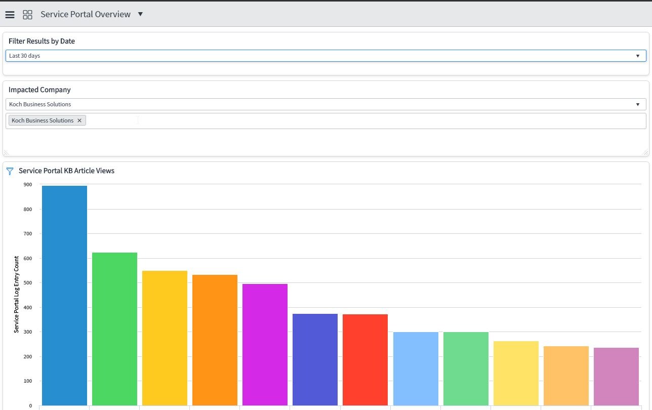

Regarding the Company field:
The sp_log table doesn't have a company field, but it does have the User field, from which you can dotwalk into Company.
I solved for this by creating a dashboard off of the Service Portal Usage Overview homepage, and creating an Interactive Filter for the User.Company field.
You could also modify the existing reports on the homepage to stack by User.Company, but I found that to be a little messy. If you only have a few Companies in that table, it might work better for you.
