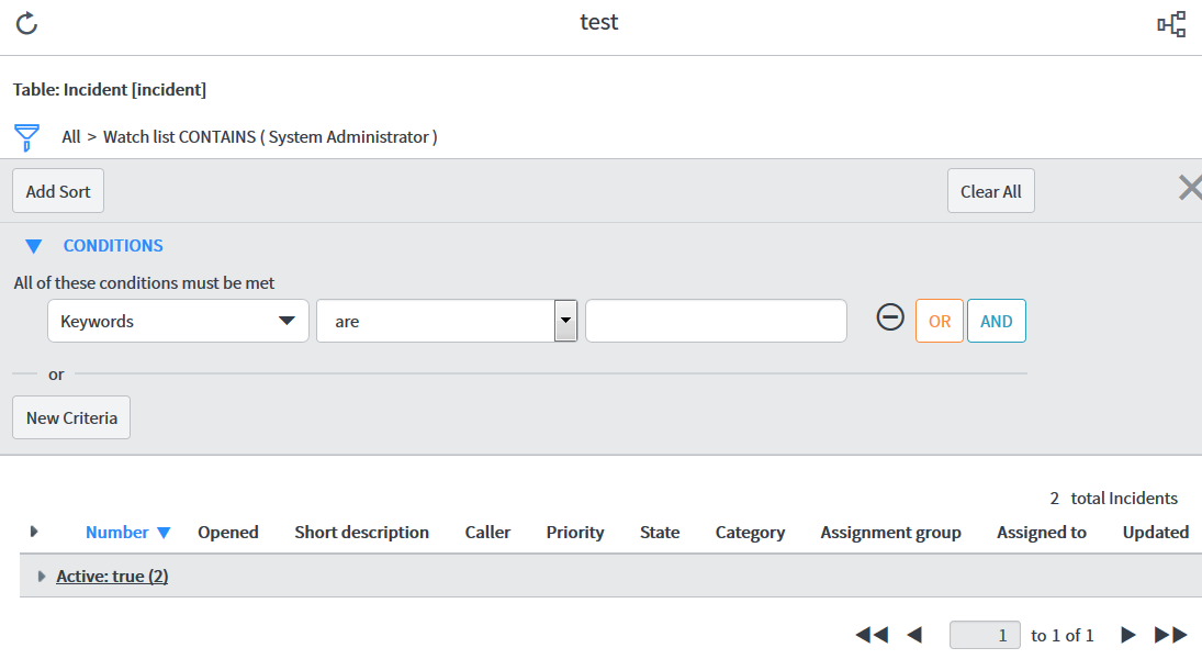

Ah. I was just throwing it together really quickly in the listview since I mistakenly assumed they would be the same. My bad about that.
Unfortunately, I don't have a good way to do this.. So how about a bad way? 😃
First type "sys_report.list" into the filter navigator and hit enter.
Then locate your report and open it. Ignore its pleas that you use the report builder to edit and then change the filter as you want.
If you go into the report now it will display the filter.. kinda.. correctly. I don't recommend trying to update the report from report builder after you do this.
