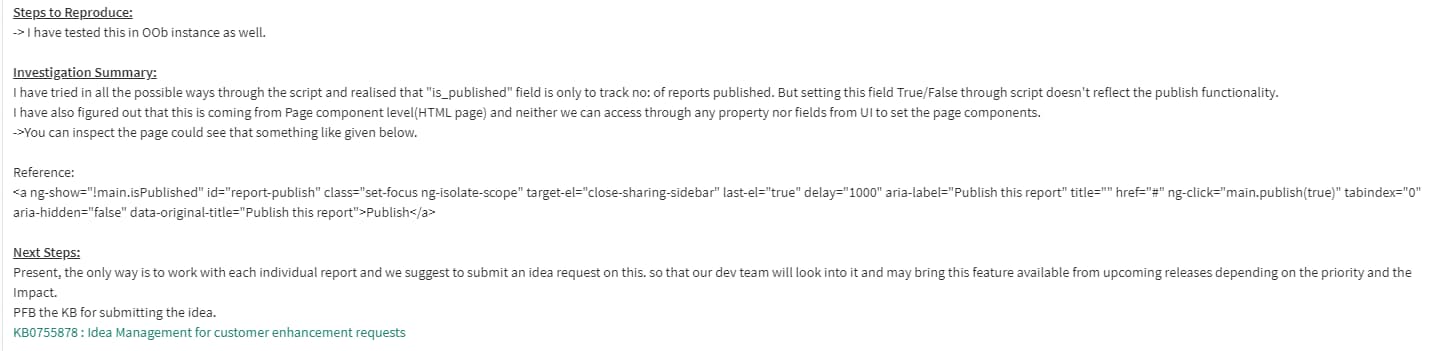

Hi, I ended up raising a HI Case to ask SN about this and this is what they responded. (basically cant do it with script)

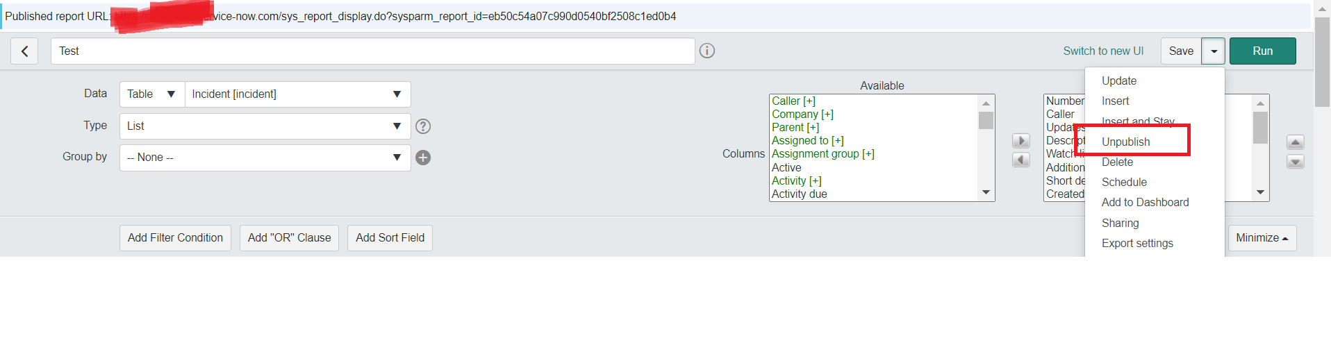

Ankur Bawiskar
Switch to Classic UI and you will see the option of Unpublish
