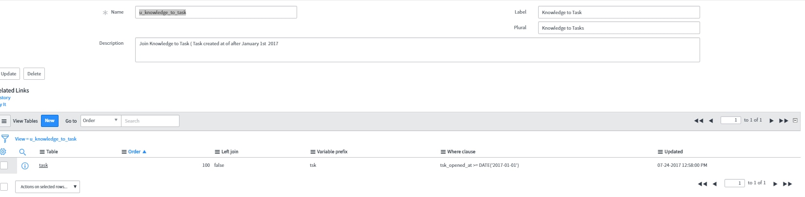

I need the where clause with 2 conditions :
1- tsk_opened_at >= DATE('2017-01-01') but nothing happend.....
2- (tsk_sys_class_name ='request' || tsk_sys_class_name ='incident' || tsk_sys_class_name ='catalog task' || tsk_sys_class_name ='external customer support' )
I have tried in differents way many times without any results.
Coud someone advice me ?

It seems you cant create a DB view with only one table, a workaround would be to add the task table a second time with prefix tsk2.
Then in tsk2 where clause set:
tsk_sys_id = tsk2_sys_id && tsk_opened_at > '2017-01-01 08:00:00' &&
(tsk_sys_class_name ='sc_request' ||
tsk_sys_class_name ='sc_task' ||
tsk_sys_class_name ='u_external_customer_support'
Also make sure you are using the table name, not the label, for example sc_request instead of Request

The below should work
tsk_inc_opened_at>='2017-01-01'

Sorry, it should be
tsk_opened_at>='2017-01-01'
