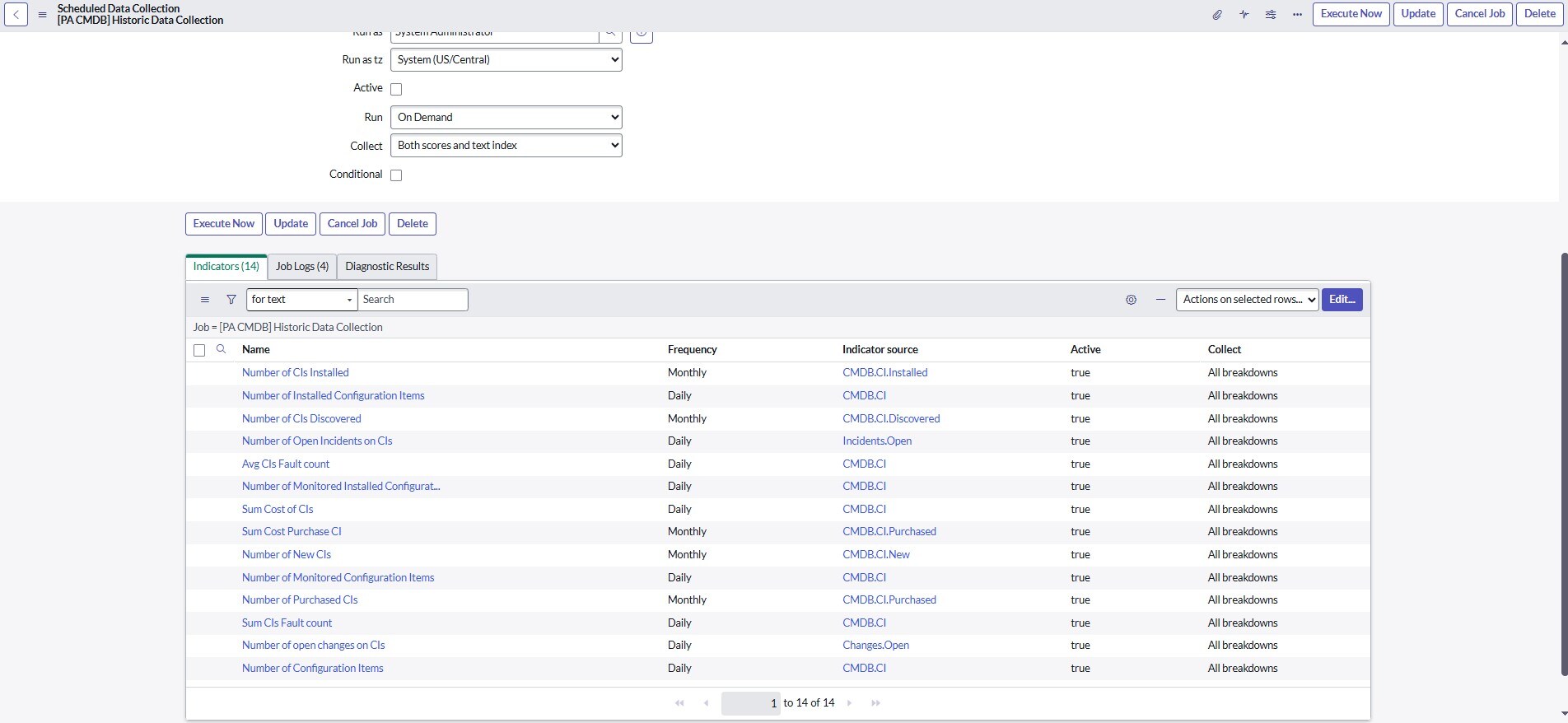

@Shivalika attached are the screen shots of the Automated Indicator, Indicator Source, and Collection Jobs.  As you can see, the Indicator Source preview shows 1.24 million records found but when I click on "Explore Indicator" or "Scores for this Indicator", it comes back with the 'No data to analyze yet' error.

I saw all - indicator source, automated indicator and historic and daily data collection jobs.
Things seem fine to me. Just one thing your automated indicator is valid for frequency daily but you are applying it in monthly job ?
Second in your daily data collection job, change the start interval to 2 days ago , the end interval is 1 days ago which is fine.
After this, After running the jobs are you able to view the scores in the related links in the indicators ?

The jobs are set to either daily or historical.  There are some indicators that are set for monthly, but the particular one I am focused on is set to daily.  I have also manually triggered the jobs to run so I would think that there should be something in the results at least from the historical job.  Again, all of the indicators, sources, and jobs were out-of-the-box.
I did update the relative start day to 2 per your instructions.  Still not getting any data when I view the results of the indicator.
