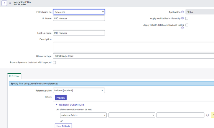

Hi Vasuki,
I have a straightforward solution for this problem. If anyone is experiencing a similar issue, just follow these steps:
  1. Navigating to Report -> Administration -> Interactive Filter
  2. Create new interactive filter based on "Reference"

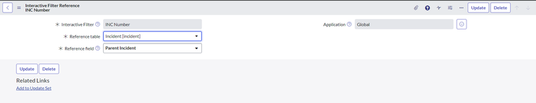

  3. In "Interactive Filter References" Related List, create new.
  4. As the Incident Number field is a string, it cannot be utilized in the reference interactive filter. However, we can leverage the parent incident field instead.
    Output:
