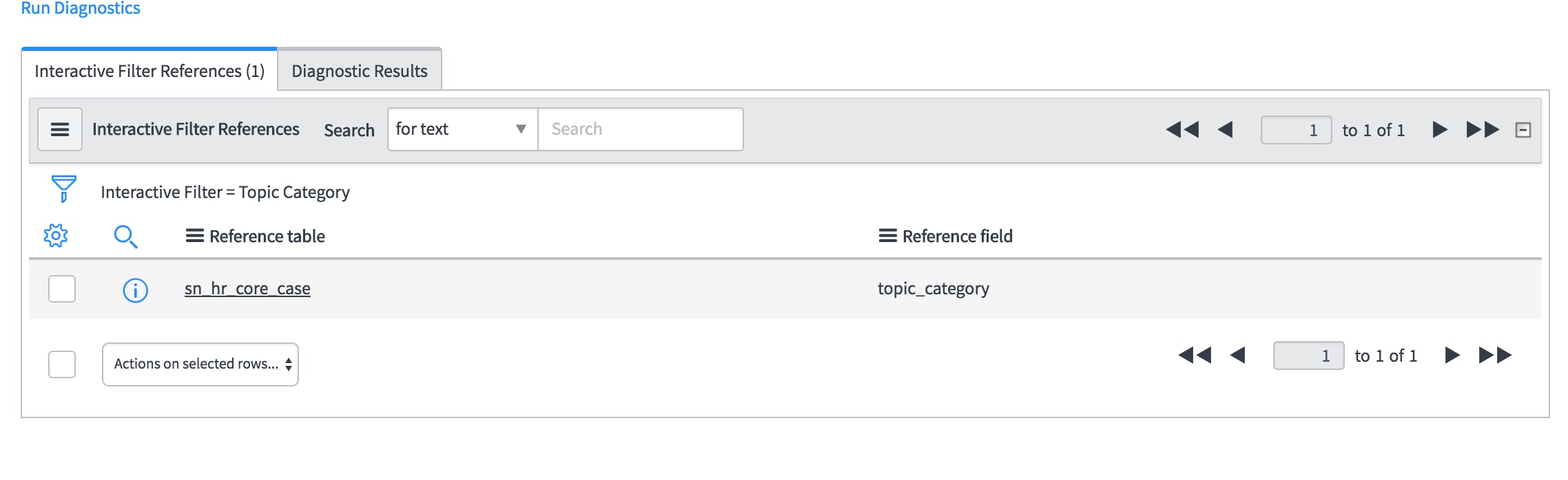

I created a simple dashboard using a report that shows specific cases. When I try to add an interactive filter using a reference, the filter does nothing. It shows: "Related list is empty". During the creation of the filter however, it showed the values I wanted to see. For the filter I use "Customer_account" as reference table. When I tried with another filter, I got to see a list of customers in the dashboard. When I select a customer however, I still keep seeing all the cases, so no filtering is done. The widget is set to "Follow interactive filter" Thank you in advance for your help.

Can you please check that you have mapped the reference? (in the related list , at the bottom of the form -> see screenshot)
My screenshot is an example OOB, it is just to show you where you should add the mapping.

Hello Quentin,
I'm going to check. Thank you for your swift reply.
‎12-12-2018 11:11 PM
Everything works. Thank Quentin, you're a genius! Have a nice day.
