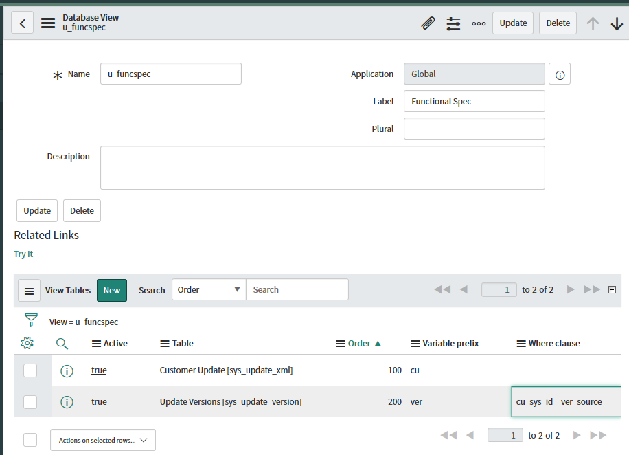

Does anyone know if it's possible to use Document ID fields in joins on Database Views? (I know that Doc IDs behave differently to Reference fields)
I'm trying to join the sys_update_xml table (cu) to sys_update_version table (ver) WHERE cu_sys_id = ver_source.
A bit of google searching suggests this is possible from one of Tim Woodruff and Martin Wood's books, but it's not working for me.
My view config is shown below. It just returns an empty list. Reporting on either of the tables individually returns all records and fields successfully.

There are several OOTB views that join on Document ID (see incident_sla and incident_metric as an example). You just want to join with the table field as well.
That being said, what is the use case for joining these two tables? What are you trying to get to? Perhaps there is another way.
10-03-2019 02:27 AM
Thanks for your response Adam.
It looks like incident_sla actually joins on a reference field, but I can see that incident_metric joins on a DocID as you say.
I'm not sure what you mean by 'join with the table field as well' though? Can you give an example? It doesn't look (to me) like the incident_metric view is doing anything differently; it's filtering the first table by 'table = incident' - is that what you meant? In which case, I don't have that field available to filter on with these particular tables.
