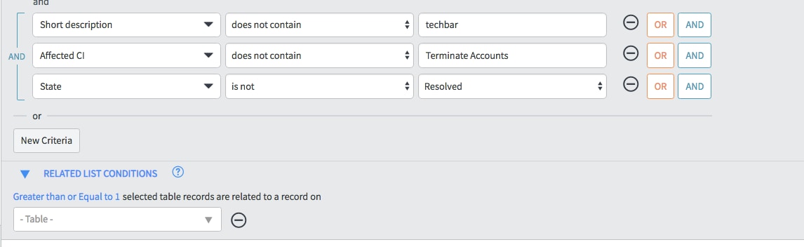

12-13-2018 10:11 AM
12-13-2018 10:23 AM
Yes what you're looking for is the Related List Conditions functionality in the report.
Research how it works. I believe that's exactly what you're looking for.
Here's the wiki on it: https://docs.servicenow.com/bundle/london-platform-user-interface/page/use/using-lists-v3/task/create-related-list-query.html
