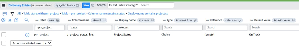

In our case, the field Project Status, is a custom field type Choice. With choice values Cancelled, Complete,Delayed,On Hold,Behind Schedule,On Track. The values are selected manually, therefore have no relationship with the color indicators nor the status report. All of the project records have a value selected, yet total counts shows "undefined"

Good, that rules out the health rollup theory then, since your values are choice-driven and manually set, not fed by Status Reports. That actually points somewhere more mundane, and honestly more annoying to track down: a field label collision on pm_project.
Out of the box, pm_project already ships with an element also labeled Project Status, the one that rolls up Green/Yellow/Red from the Overall Health field on the most recent status report (this is the field my original answer was describing). If your custom choice field was built and labeled "Project Status" without renaming or checking for a collision first, you now have two separate dictionary entries on the same table sharing the exact same display label. ServiceNow's reporting and grouping tools resolve fields by label in a lot of places, and when two elements share a label, it's a known pattern for the tool to bind to the wrong one, in your case almost certainly the original OOB element, which is null on every project that's never had a status report submitted. That would explain exactly what you're seeing: your custom field is populated on all 41 records, but the pie is grouping on a different, empty field underneath and rendering that as undefined.
Steps to confirm and fix:
- Go to System Definition, Dictionary, and filter on Table equals Project [pm_project] and Column label equals Project Status. If you get back two rows, you've found it. Note the actual column names of each (something like project_status for the stock field versus whatever your custom element is named).
- Open your data visualization's Group By configuration and check which technical element it's actually bound to. If the picker only shows you the label, add both fields as columns on a pm_project list view instead, that will make it obvious which one is which and which one is actually null across your records.
- Once confirmed, rename the label on one of the two fields, ideally the OOB one if you're not using it, or your custom one to something distinct like "Project Health Status", so there's no more ambiguity. Then rebuild the Group By selection in the visualization pointing at the correct element and it should stop returning undefined.
- While you're in there, also check System Definition, Choice Lists, filtered to pm_project and your custom element, and confirm all six values (Cancelled, Complete, Delayed, On Hold, Behind Schedule, On Track) exist as active sys_choice records tied specifically to that element. If any project record's stored value was set by import or script rather than picked from the dropdown, it's possible to have a raw value with no matching active choice record, which also renders as undefined in aggregated views even though it displays fine on the form.
My money's on the duplicate label. That kind of collision is easy to create by accident when a custom field is named to match what people are used to seeing, and it's exactly the kind of thing that only shows up once you start aggregating instead of just viewing the form.
