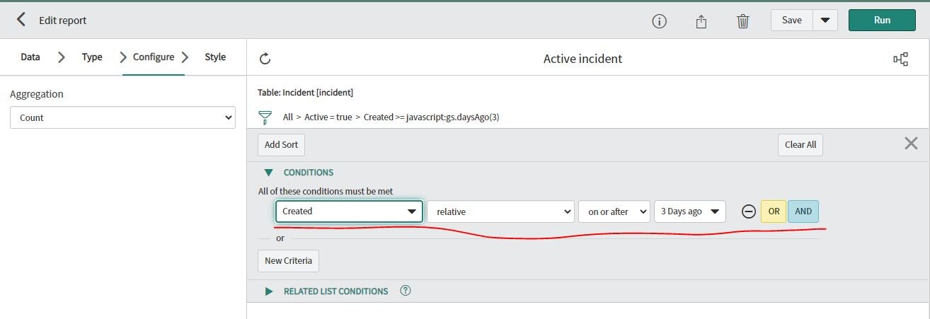

Hi Aaron,
Use the filter condition as shown in below image.

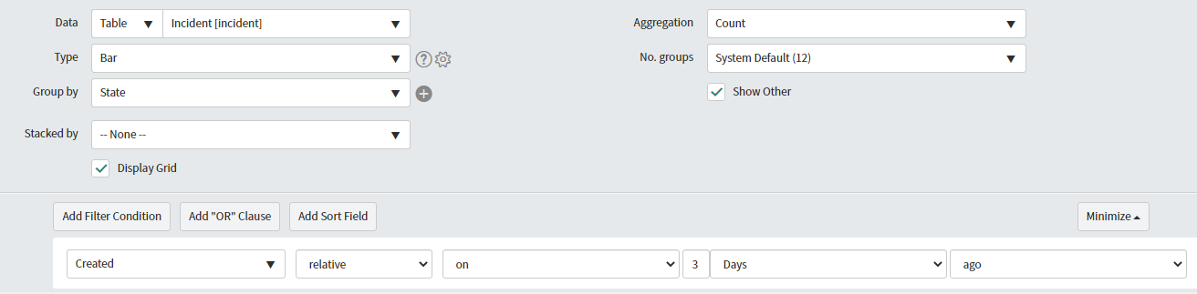

Dhananjay Pawar
Here is your report filter condition, which will give you last three days records.
Mark correct/helpful based on impact.
Dhananjay.
