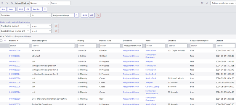

Whenever I was trying to tell the story of bad assignments, I'd simply report on the Incident_Metric table where definition = Assignment Group.  That's a log of every time the group changes, and who did it. You can get the same story, you just don't need to spend 1000 hours creating a custom solution on the platform.
The incident_metric table joins Incidents and metric_instances.  Its VERY important that you look at the sorts carefully.
Add sort:  inc_number (the incident's number)
Add sort:  mi_sys_created_on (the created date of the metric instance record)
Make sure your list view shows the Created (mi_sys_created_on) and not any of the other created fields.

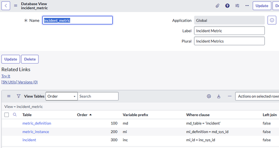

1. Any insight into how to create the incident_metric table? (We currently have the metric_instance table and incident table but not incident_metric)
Hey @ChristinB - go to your navigator bar and type in incident_metric.list.
Its an OOB database view that isn't found on the navigator bar, so you have to manually nav to it.

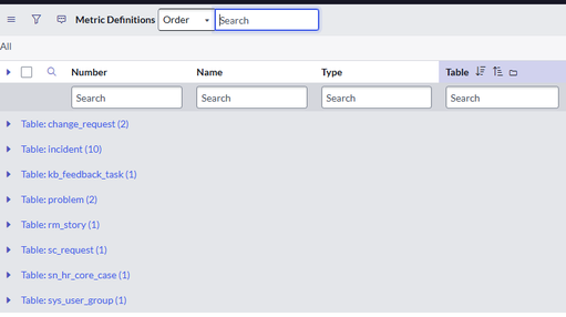

1a. Is it possible to do the same for sc_task table as well?
VERY Possible but not OOB.  Before you have a DBView joining metric_instance to <whatever table you want>, you must first have Metric Definitions [metric_definition] creating Metric Instances.  Here's the OOB definitions grouped by table.  Doesn't look like there are any sc_task ones defined.  Good news is you'll get practice.
Its easy to define the Database Views since you'll have incident_metric as an example
