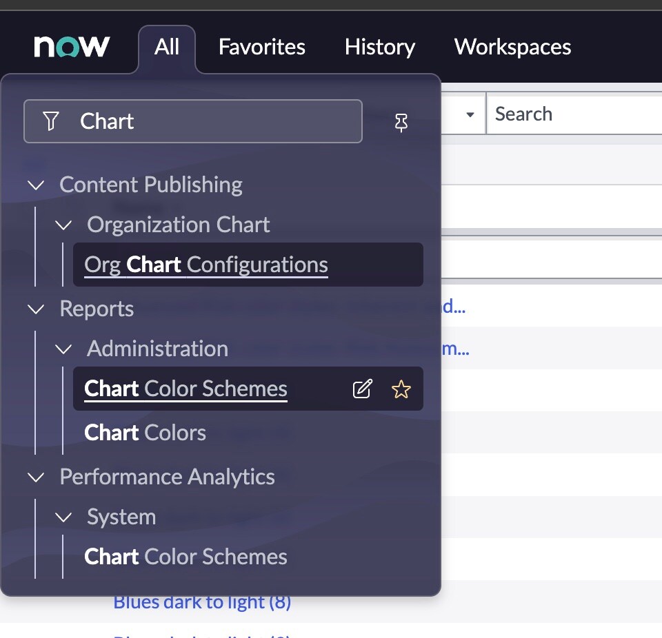

I am new at this and may have missed it.  But I have not been able to see direction on how to create a new Palette.
I see where the default shows where I can create a New Chart Color scheme or Create a New template but I am not sure what is the impact - on how it works  - pointing me out to the documentation or steps will be greatly appreciated
kristymerriam
Administrator
You can create new Chart Color Schemes (palettes) using the Chart Color Schemes link under the Reports module:
One thing to keep in mind -- if you are using colors not part of the existing palettes  -- you have to "create" the different colors to then create a new palette and chart colors.
