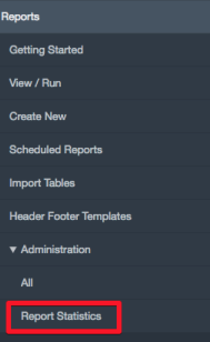

Go to Reports > Administration > Report Statistics and it will show you the Recent run time for the reports that take the most time to run.

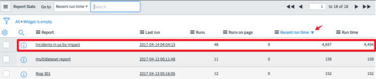

Identify Slow Reports
- Go to Report Statistics module.
  1. Relative
  2. Sort z->a platform list results by Recent run time. You can see the reports that take more time to execute on top of the list.
    Relative
  3. Identify the  slowest reports within your test instance.

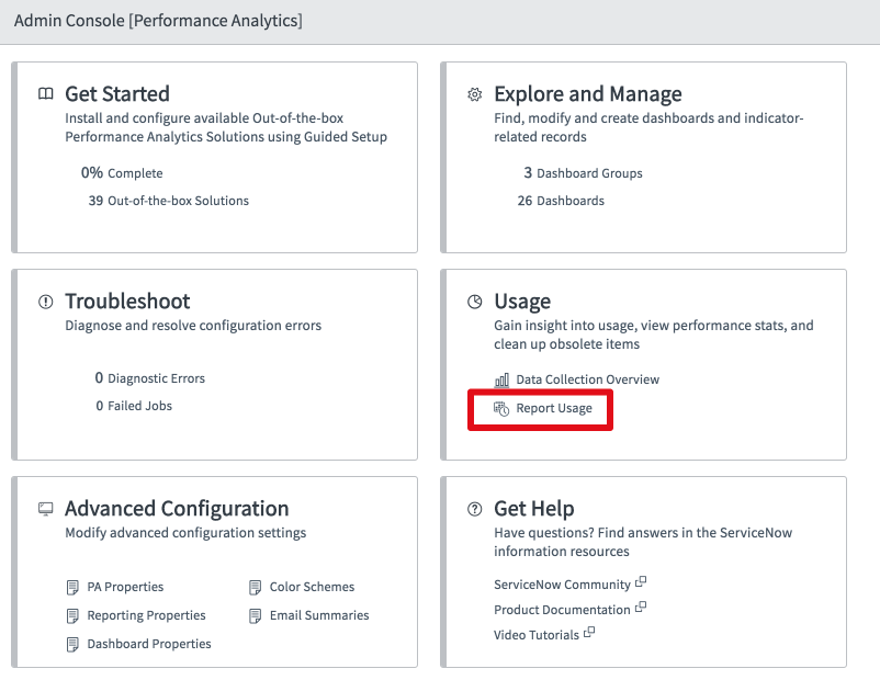

  1. Navigate to Performance Analytics -> Admin Console
    Relative
  2. Click on Reports Usage link (under Usage Section)
    Relative

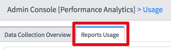

  3. Click on Report Usage tab
    Relative
