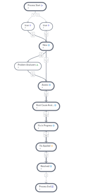

Can you please explain how to read this process map shared below-

4 items have gone through the process:
- 2 went down the "true" path and 2 went down the "false" path.  No idea what field is providing the true false field value.
- The numbers written on the arrow lines are the quantity of records and the average time on that journey.
- This is showing that 2 records moved from New to Problem Analyzers, and 2 others went to Assess.  Remember again, the arrows are showing you quantities and average times.  This can help you explain (at scale) why certain things take so long.
- This section is just showing you that all 4 items went in a strictly linear fashion down through the other states in order.  Once again, lines show you how many and average time.  This is a lovely visual way to tell you what parts of the process are consuming the most time.
These maps get WAY more interesting the larger and more varied the data set.
