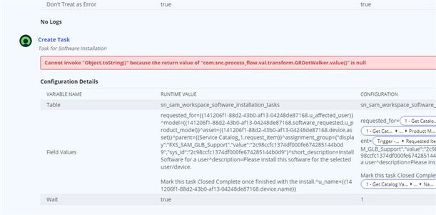

I have created a string field on " sn_sam_software_installation_task" table called as Name, I want to copy the variable called "device" value into Name field So I am using the flow designer but I am getting below error.
but when I tried to add logs I am getting the correct value.

seems you are using toString() on a empty or null value and hence it gave this error.
Is that variable i.e. name an empty string?
share that detail, but you are not setting "name" field in your Field Values

so the variable "device" is reference type and you are dot walking and getting the name?
but where are you setting it in "sn_sam_software_installation_task" step in "Create Record"?
I couldn't see it in this below image
Did you hard-code name field and see if it creates that record?
Hi @Ankur Bawiskar ,
yes device variable is reference field and  I am setting the values in create task at last step as below:
also the same thing is working for some devices and throwing error for some other.
